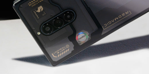

For most people, the only part of their smartphone they have to worry about constantly cleaning is the screen. The speaker and the charging port may occasionally need a good touch-up, but that’s usually as far as it goes for cleaning the hardware. If you own a gaming smartphone, particularly a REDMAGIC with one of those super powerful 20 000 rpm internal fans, you may need to clean one more part of your device - the cooling fan chamber.
It’s not uncommon for pocket lint or dust to get into the tiny nooks and openings of your phone’s charging port or speakers, and the REDMAGIC cooling chamber has more potential to draw objects into its openings with the powerful fan if you happen to be playing in a dusty area. If your REDMAGIC gaming smartphone has a solid back panel, you can probably get away with just dusting particles off the grille with a soft paintbrush or toothbrush. However, if the cooling chamber is visible through the transparent back panel, then you may feel the need to keep it extra clean. Don’t worry, we’ve got a few tips to help you out.
